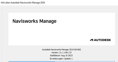

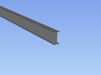

Message 10 of 12
Sebastian_Eiche
additional: If I load your IFC file into my navisworks...the result ic complete another as it should be
I know there're C- Profiles...but Navis show me a HEA100 and a UPN260
I'm a bit confused 🙂
Sebastian Eiche
Application Engineer @Mensch und Maschine acadGraph
If this information was helpful, please use the Accept as Solution function, this make it easier for other users
Sebastian Eiche

Message 12 of 12
Sebastian_Eiche
the conversation method was the point.
I never changed this as I Know. In germany this is called :
Which could be translated to:
  1. "older version"
  2. modern
  3. v3
So "older" version sounds not good to the most users =).
But now it works and maybe this is a setting which helps others
