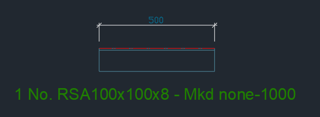

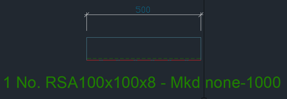

Take one main part profile, set the UCS to object and rotate the axis as needed for the view of the profile in the drawing (X and Y orientation). Now you can set the "inner" UCS part for drawing via the Define assembly detailing direction (it write the actually UCS into profile - via right mouse button on object you can see the Main / Single part UCS - it shows red view definition with object UCS) This is a UCS related to part creation, independent of the future UCS of the workspace. Now try to create a drawing of this profile. If you change the inner UCS one more time, it should change the profile orientation in the drawing after the update).

creating of new profile incl. numbering (to get SP / MP):
the drawing for the new profile:

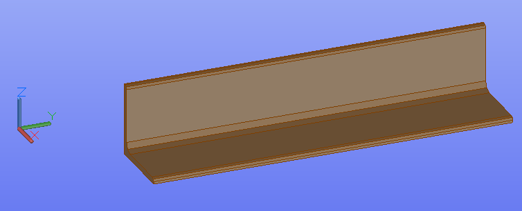

right mouse button on object - to show the Assembly CS (it disappears after REGEN) - this CS is in this case different from what is needed in the drawing:
new definition for UCS on object (for workspace too):
apply the current UCS to profile Main Part (Assembly CS):
test of new Assebbly CS - the rotation of the profile as needed:
new profile orientation on the drawing after update via Document Manager:

Apply both assignments for new CS (Object detailing direction and Assembly detailing direction)
