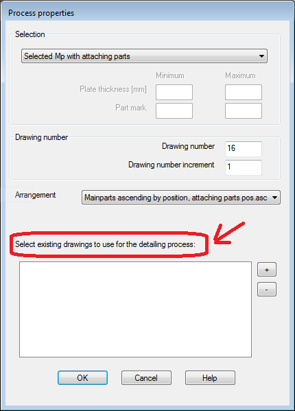

Dear expert,
          Which purpose for this in Drawing process manager?
Thanks & Regards

If you have run a drawing previously, by selecting the plus button , the new drawing views can be added to that existing drawing. Typically used in arrangement style drawings, where user has an extra view they may wish to add via a camera process, to a drawing they previously created.

Dear expert,
                    Can be used for assembly drawing with parts?

if you press the "+" button you could select any drawing, it's not limit to a specific process.

Yes it can be used for any type of drawing process, but typically and assembly process would have created a number of views relative to the main view, using the style configuration.
Also I noted you have a process of assembly with parts, so that would call for a style of assemble any secondary step for associated parts, so I would be careful what you are trying to add manually.

Dear expert,
        I created one beam assembly drawing with parts from drawing process manager. After that, the model modified some parts added and then numbering process done. now, the added single part to add the previous created assembly drawing. But, that single part created new drawing only, not add the previous drawing. please clarify.
