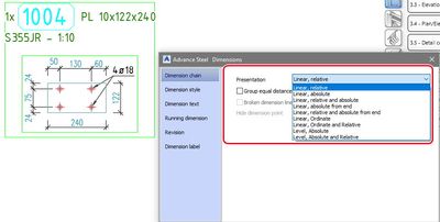

How can I set the dimension shown in the attachment?
1.1.png thank you
Message 5 of 11
Sebastian_Eiche
double click on the dimension and then change the type of the dimension. If you want to do this for everytime, it had to be done in the drawing style manager

Message 6 of 11
Miguel_Abreu
I can not find.
You can attch an image?
Thank you.
Message 7 of 11
Sebastian_Eiche
you only had to double click on the created dimension. if you want to change it on a complete details just select one dimension, right mouse button click and then "select similar" then right mouse button click "Advance properties" and you will see the dialog, where you could change it.

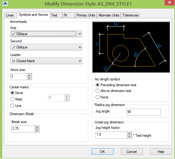

Message 11 of 11
Sebastian_Eiche
this is in the first tab "Lines" there should be a value for the "distance to origin" or something similar
