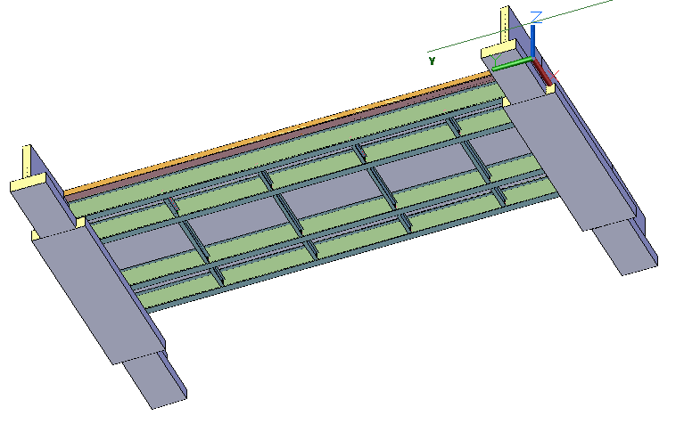

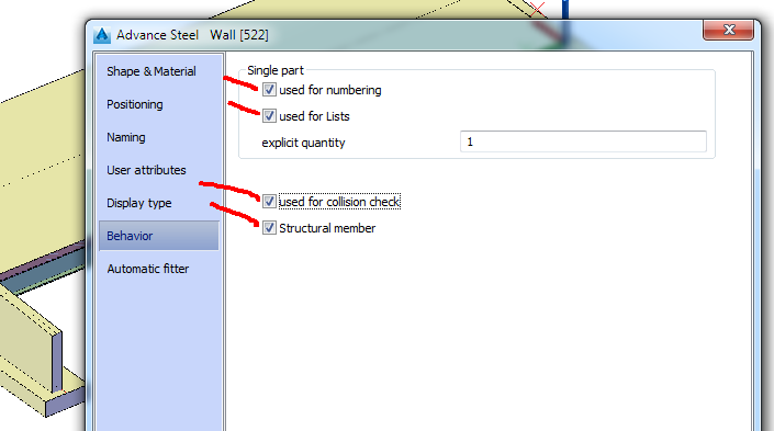

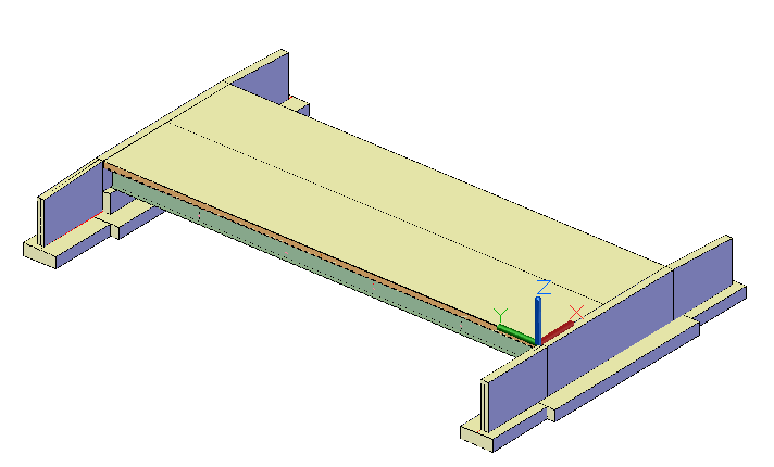

We have modeled a small bridge and was hoping to use AS to generate a close estimate of the concrete volume (cubic yards) for the abutments... obviously we are doing something wrong and cannot figure it out... can anyone help? maybe @Kirk_bailey or @AleckGiles

The reason that your concrete is not appearing on BOMs is the Report Contents.In the BOM Editor select the desired list and right click on the name and pick Report Contents. Then tick all the concrete type objects i.e. Slab, Isolated footing, Concrete Beam and Concrete Beam Bent. Save the template. Then your concrete items will show on that BOM.
Volume is not a property Advance Steel has available. Therefore I can only see two options.
1) Export your list to Excel and divide the weight by the density. Density is not availabe from AS BOMs either.
2) Set the BOM to show DIm X, Dim Y and Dim Z. This give the envelope dimensions of the item. This is intended generally for packing purposes as in what size crate is needed. So the volume will not be precise but multiplying those values will give some idea.
If you make a BOM on a drawing you can make your own formulas using the 'Formula:' token  so you could multiply the dims in the BOM. Formulas are not currently possible in separate lists.
I hope that helps.

Thanks, we figured it out with help from many people. It was frustrating as we had to play with weightsd s and densities many, many, many time in tables . But we did get it to work....

This process, you need to use a formulae in the bom template to calculate the volume,  it’s the cubic cm/inches x the density value.
using the various tokens and the calc you can arrive at the solution.
https://youtu.be/be4LcHHPbWI
