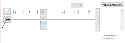

my experience with Advance Steel say: compliant with the standard (ISO, DIN) Advance Steel automatically creates the required welding symbols. In the case of asymmetrical welds, the dashed part of reference line appears automatically (se below), because it is not necessary for symmetrical ones. The a- or z- valu can be defined as the prefix in each weld connection.
An example:
The problem is - the a- or z-letter can be defined as prefix for one one side only, which is unacceptable. Therefor I use no letter for corner weld, it will be always a (I haven't seen someone prescribe the z-value in a long time)

The dashed line appears automatically, you cant set it. Creating a weld is not the same as AutoCAD Mechanical, where it defines everything from the ground to the sky 🤣
There is already a request from me in the Advance Steel Idea Station, but it's a futile effort.  Advance Steel creates a dashed line whenever it really has to, then I haven't seen a single case where it didn't work. It's one thing if the weld symbols are generated automatically from the model or you create them manually in the drawing ... it works very good. Make small assembly (eg. 2 plates ...) and create a weld. After you generate the drawing for the main part, you will see more 😁.

you can edit the weld symbol even in the drawing, but the prefix can be set only for the weld above (here at German).
Main weld definition:
Double weld definition:

Identical weld definition up and down = no dashed line (no needed):
Different weld definition up and down - dashed line appears automatically:
