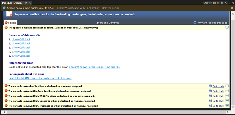

I download SDK 2023 and try to built and run the sample SampleJoint.dll, I followed these steps:
1. Open AdvanceSteelSamples.sln by Visual Studio 2022
2. Add missing references
3. Get new GUID and change in code of namespace SampleJoint
4. Add infomation to AstorRules.HRLDefintion and AstorRules.RulesDllSigned
5. add ActiveX control
6. Rebuild SampJoint, coppy dll file to C:\Program Files\Autodesk\AutoCAD 2023\ADVS\
7. Run Advance Steel, Call joint with astm4crconbyvb <jointName>
Command: AstM4CrConByVb
quy77
Select beam
Select objects: 1 found
Select objects:
The parameter is incorrect.
When i open Page1.CS, it show like below picture, then i click ignore and continue
Please help me where am I wrong. Thank you so much!
