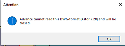

B.Bevelander
I get an error trying to import your Connection:
JW_Lotz
I ll make a short video how to create the connection it is very easy.
