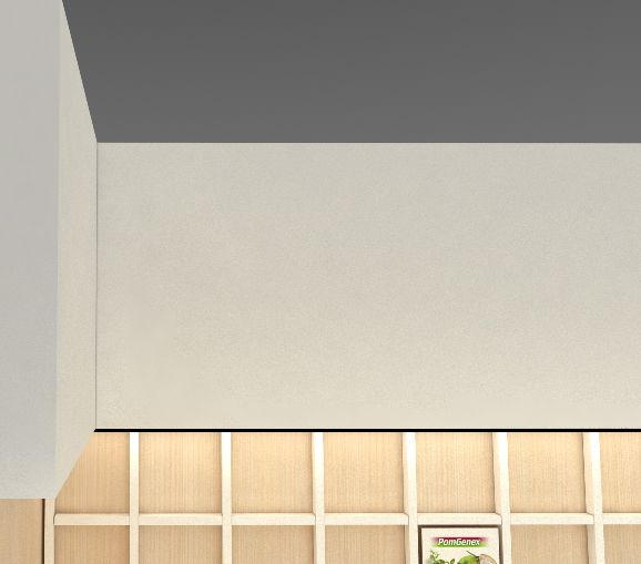

Hi, I'm having a problem with the outcome of my rendering. I'm not too sure is a render setting problem, material or the lighting. I'm using 3d max 2019  Vray Next 4.0DR spawner. images 01.pngimage 03.jpg
Appreciate if someone can tell me what's wrong with my setting. Thank you.

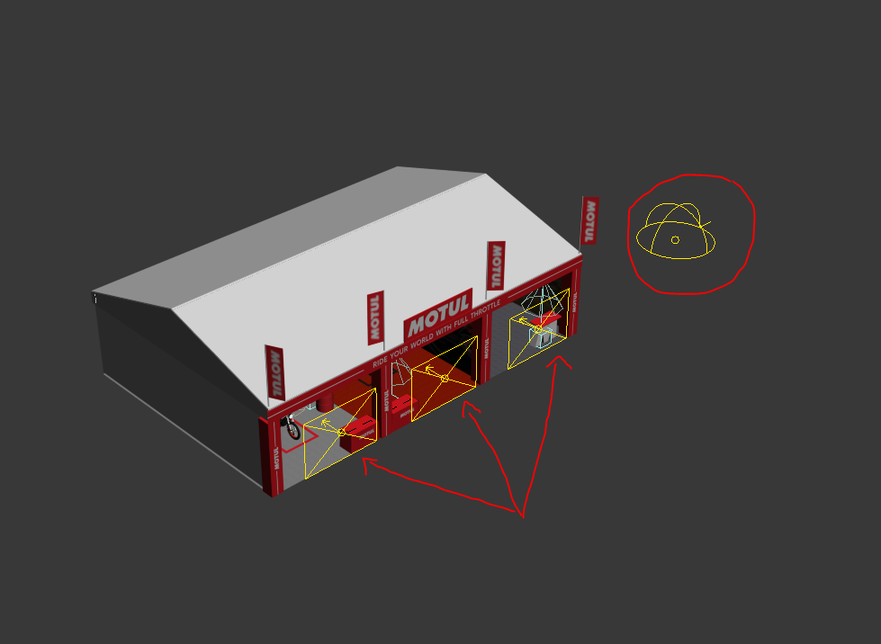

2- You have lots of light around your project that are not necessary
I deleted those V-Ray lights, in addition to some omni lights at the entrance,
And I added a V-Ray Dome light for the environment lighting
And 3 Rectangular V-Ray lights at the front the 3 entrances.
Adding Vray LightsAdding Vray Lights

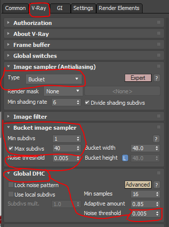

For the Noise, in the Irradiance map rollout, I set it to High with a Subdvs of 50,
And I've set the Light Cache Subdvs to 1500
Irradiance map and Light CacheIrradiance map and Light Cache
Also, in the Vray tab, you can check the settings below
Image Sampler...Image Sampler...

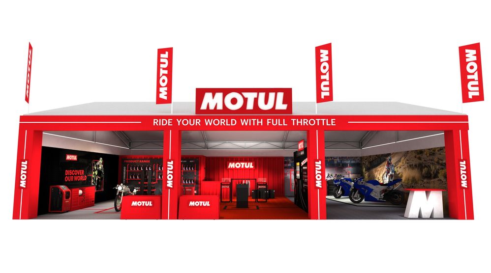

This is the render after the few adjustments I made:
You can continue adjusting the scene as you like, maybe adding or deleting lights to
Emphasize some areas, etc,...
