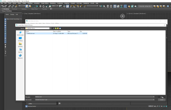

Max material library2.jpgSo I try to open the material library. Weirdly it is only possible from a really small arrow in slate mode. (There is no material library to found in compact mode.) The dialog opens up materiallibraries folder (which includes files on the right, including MAXtoA downloaded in previous step. The dialog shows nothing (middle). Nothing can be opened?

Message 2 of 15
Stephen.Blair
Just click Save in the Create Material Library dialog box.
https://www.screencast.com/t/X6Yt2c6pC
// Stephen Blair
// Arnold Renderer Support

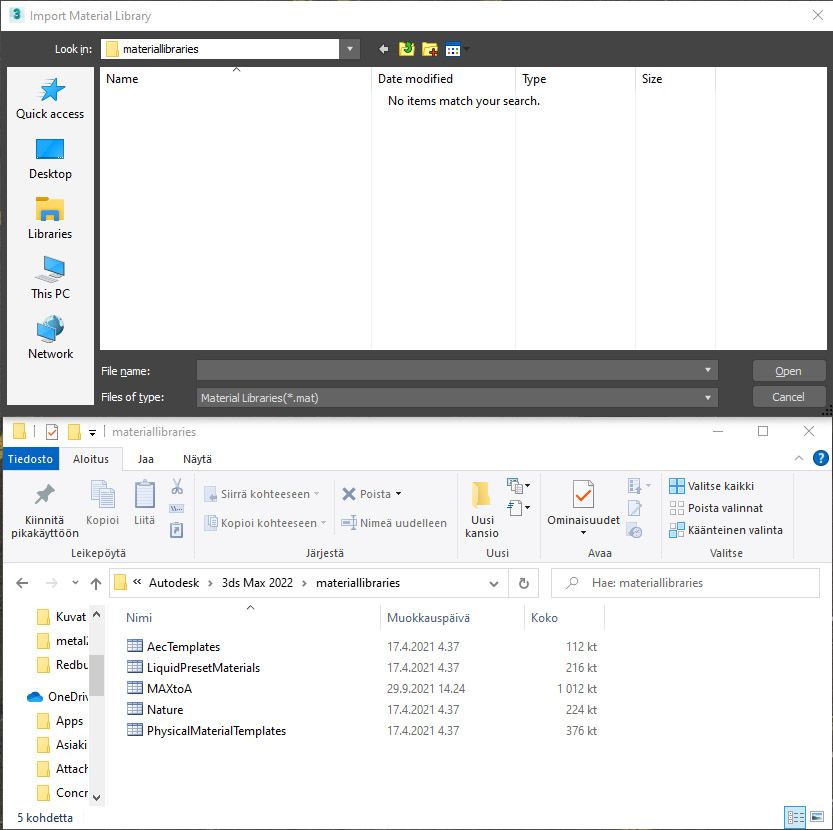

pietarivisanti
How do I open a material library when Max can't show any material libraries I have in the material library folder? I can't save a material library Max can't see.

@pietarivisanti wrote:
How do I open a material library when Max can't show any material libraries I have in the material library folder? I don't want to create a material library from scratch. I can't save a material library Max can't see.
I see five material libraries in that screenshot.

pietarivisanti
The upper part of the image is from 3DS Max 2022. The part below is from Windows File Manager which contains my material libraries. Unfortunately 3DS Max can't see these files. The respond is "no items match your search".

oliver
Watch out: the default "Import library"-dialog opens in the project's materiallibraries-folder! You have to navigate to the program's materiallibraries-folder.
Message 8 of 15
pietarivisanti
Thank you. I was really confused why 3ds Max 2022/materiallibraries had nothing in it when the folder clearly had stuff in it. The whole path in Max was Documents/3ds Max 2022/materiallibraries, which does not work.
