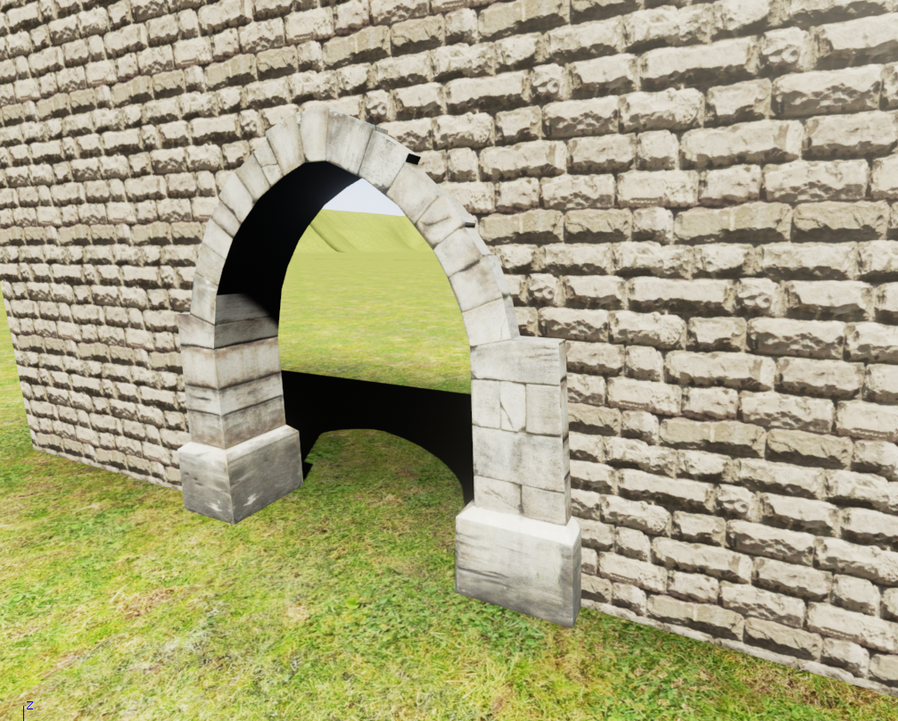

Hi, thanks. Sorry for the late reply, I've been trying out some of the things you mentioned. I'm actually creating resources to be exported to the UDK game engine that supports importing the FBX file format (including standard and multi/sub-object materials, material id's, UV maps, and smoothing groups). So I'm still trying to work out the best method for maximising/optimising mesh and texture reuse.
I got a pretty nice arch using the collapse and bake method you mentioned (thanks) (see attached - arch using Unwrap UV and walls using UVW Map tiled) and also tried Rendering to Texture, but am not sure I'd be able to use this as am trying to apply textures to large buildings that may have walls that need tiling, and I guess at the end of the day I need to export my textures at maximum 1024x1024. Think collapse and bake should be exactly whats needed though.
Thanks again for all your help,
Bruce
Steve_Curley
I did play with UT back in the day - there were bitmaps in there for a dozen different objects all in one big bitmap - it was the UVs which determined which section got used on a specific model, so the image was only loaded once. Of course both PCs and Graphics cards had an awful lot less memory then than is common today, but to coin a phrase "every little helps" 😉
That looks pretty decent for a game asset - keep it up 🙂
