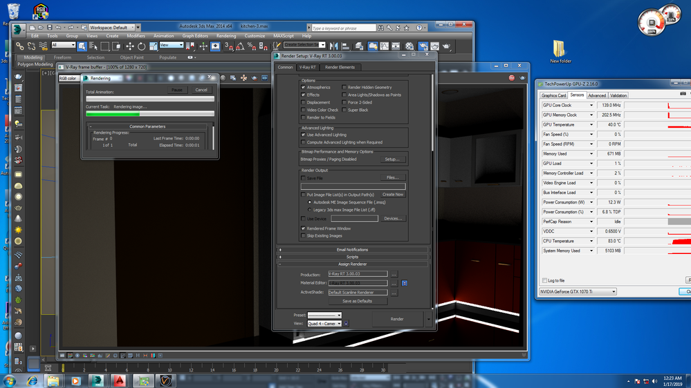

Choosing render window in Production rendering I select VRay RT.  During render GPU did not take any load. I am sending you screen short.
Message 6 of 12
In Render window after selecting production rendering  I choose VRay RT.  But it is seen GPU did not take any load. I send you a screen short regarding this. But when I render in after effects GPU is taking load.

Still I do not solve it. In render engine I select VRay RT engine under assign renderer. Under VRay RT I selected CUDA(Single Kernel) as engine type. But GPU did not take any load. In tutorial there are many permutation and combinations. But I want a simple render settings that I can run my graphics card. The persons who are using Nvidea gaming graphics card (CUDA core) or Quadro for, use only Vray RT to run graphics card? But some professionals who are using Quadro graphics card, they use VRay Adv (Not VRay RT) as render settings and getting Quadro graphics card performance also. How is it possible? I really confused.

If you can't use VRay RT in your machine, you may need to update your Video drivers and be sure you are using an Nvidia video card.
Message 10 of 12
 you can use the supplied GUI tool, which you can find in Start Menu > Programs > V-Ray 4.0 for 3ds Max > Select rendering devices for V-Ray GPU 4.0 for 3ds Max
