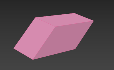

Create a box in 3dmax
Apply rotation and scaling to the box, and turn the box into a non-orthogonal parallel hexahedron.
Export it to fbx, It warned me the box is non-orthogonal.

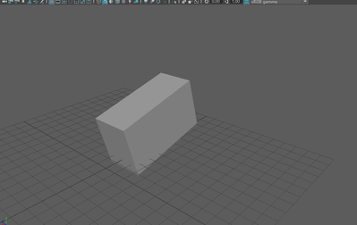

And import the box in maya, it still looks like orthogonal:

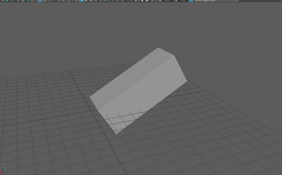

If I click Edit -> Transform -> Reset Transform, export it, and import it in maya, it's non-orthogonal.
That's what I want!
But If I use MaxScript ResetTransform $ , export it and import it in maya.
It's still orthogonal:
