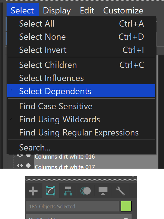

jesped
I select one object with 'Select Dependents' enabled:
Which selects 185 objects.

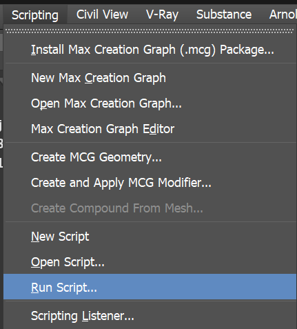

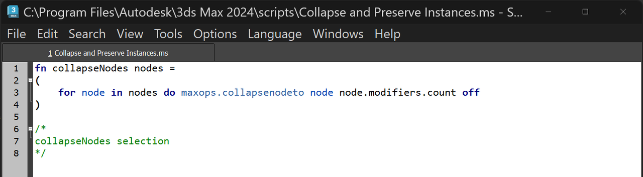

I save the script as a .ms file:
I run the script
...and nothing at all happens, with either of the scripts. Am I doing something wrong? 🤔

Message 8 of 10
denisT.MaxDoctor
first of all the executable code looks as:
for node in selection do maxops.collapsenodeto node node.modifiers.count on
second, dependent nodes are not exactly instances. There are other mechanics to find all instances of a node.
and third, if you do everything right, I'm pretty sure it will still work in 2027 at least.
