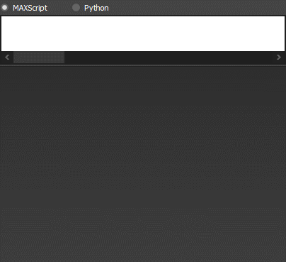

i can't find a physical camera in vray 3.4 in 3dmax and i want to download it so please send me a link to i can download it

From 2016 on, max uses new Physical camera based on code from Vlado (Vray dev), it's in the Standard category, not Vray:
If you want the traditional VRay Physical camera instead (basically deprecated and not available from the UI), enter vrayCreateVRayPhysicalCamera() in the MAXScript Listener and press Enter, it will create one.

same7_snake
it says "undefined"

Swordslayer
What vray version? Works in vray 3.40.01 @ max 2017:
What's the reason you want to use that one instead of the Physical cam? It was made based on vray camera source code anyway.

same7_snake
Untitled.pngit's not working and i don't know what is going on !!!!!

Swordslayer
So you're on a newer version 3.40.02 or 3.40.03, right? The old Vray Physical Camera is there only for backwards compatibility when opening old scenes that use it, it's not creatable and this was a workaround method, most probably dropped now. As I said, you should use the max Physical camera instead.

Swordslayer
Yes, it's now renderer agnostic (it's a part of the continuing effort to make max easier to use with 3rd party renderers) and matches the original VRayPhysicalCamera functionality. Note that when you create a Physical camera, a new Exposure Control is created and active (press 8 to bring up the Environment and Effects dialog, it's under Exposure Control) which effectively overrides the exposure settings of the camera itself - just something to be aware of.
