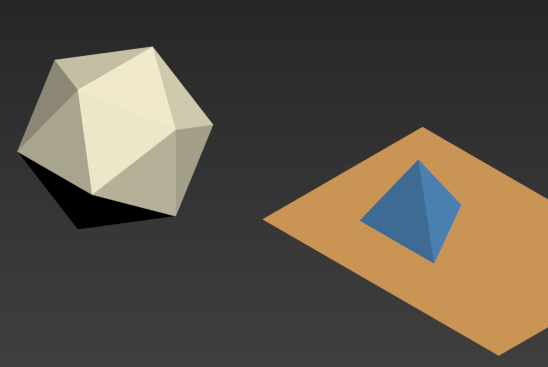

  To model the Tron bit from the 1982 movie, I am trying to create all hedrons.
   But I can't find the right parameters for modeling the small triambic icosahedron.
   Any help will be great! Thanks

You can model a small triambic icosahedron in 3ds Max by combining an icosahedron and a trirectangular tetrahedron.
To construct the icosahedron go to  Create, Extended Primitives, Hedra and select Dodec/Icos and set P = 1.  Assuming that we want an edge length of 1.0 set the radius of the icosahedron to 0.951056 (see this link for a = 1).
A trirectangular tetrahedron is formed when the three edge angles at one of the vertices of a tetrahedron = 90°. Since we want the lengths of the base of the tetrahedron to equal 1.0 the radius is 0.61252 or ( 1 /(4 * 6^0.5))   Reference this link.
We need to adjust the height of the tetrahedron to form a trirectangular tetrahedron.  To do this I created a plane on the world XY plane and then used Normal Align to place one face of the tetrahedron on the xy plane.  This face will be referred to as the base plane.
Convert the tetrahedron to an editable mesh and move the vertex that isn't on the z = 0 plane to a value of z =  0.40805    (from 1/h^2 = 3/a^2  where a = 1). This will yield a tetrahedron with a base of sides = 1.0 and right angles for the edges not on the base plane.  Reorient the pivot to the world so that its local z axis is perpendicular to the base plane.
Now use Normal align to position the base plane of the tetrahedron with one of the faces of the icosahedron.
Using object snaps position one vertex of the tetra with the icosahedron and then rotate about it local z axis to align the edges.  You now have one of the twenty tetrahedrons properly positioned!
Using array and clone you can create and position the rest of the tetras (with some pain).

I did not like the solution I posted above. Here's a much better process.
  1. Create, Extended Primitives, Hedra, Dodec/Icos
    P = 1.0
    radius = 0.951056
  2. Position it at World 0,0,0
  3. Rotate the icosahedron by 31.7175° about the world x axis. This places vertices of at the top and bottom (rather than an edge).
  4. Find the midpoint for 2 faces, one on the top series and one in the middle series. This can be done creating two lines on the face from a vertex to an opposite midpoint.
  5. Trim one line in each face then add a point to note the center.
  6. Create a line from 0,0,0 to 1.16401,0,0 then adjust its pivot so that it is aligned to the world and located at the hedra center.
  7. Make a clone instance of the line.
  8. Add a Look At constraint to each of these two line with one point at one of the points and the other at the other point.
  9. Convert the hedra to an editable mesh then create 6 new faces referencing the existing face vertices and the end of the two radial lines. This yields 2 of the 20 tetrahedrons.
  10. Detach the 6 faces to form a new object the Array rotate the shape 5 times 360° around the z axis.
  11. Clone/Instance the collection and rotate them by 180° about world x.
  12. Using snap vertex move the group into position.

I am starstruck by your detailed and thorough answer LeeMinardi! Thank you very much.
Your method did work quite well although I did adjust thing manually for a more simple approach (but less precise than you).
