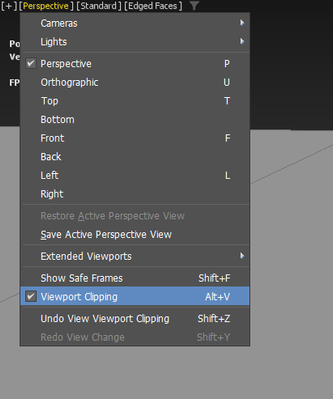

Hi guys. I dont know what the problem is, but it is truly driving me crazy at the moment. When i try to add trees, they only appear within a certain area of the viewport. When i try to move them further away to add a treeline background, the trees just vanish, but the object is not deleted. I added a short video clip of the problem. Any ideas what the problem is?

It looks like you have some type of Viewport or Camera Clipping enabled.  Like the trees fade as they get to the clipping distance.
 Couldn't tell from your video whether you are using a camera or viewport view, but Cameras have separate clipping controls.

Dude! Lifesaver. That was exactly the problem, and I probably would have spent a day solving this, if it wasnt for you! Thanks!
