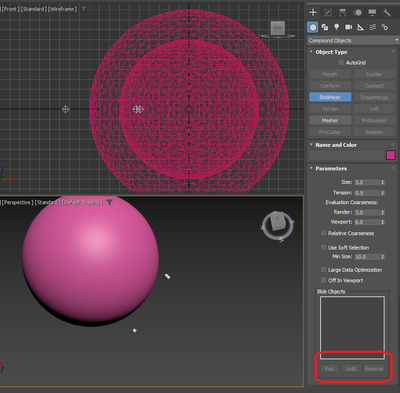

Hi All,
I am trying to learn to use the Blobmesh feature. In most tutorials (including the official), there is a step to distribute the blobs across another object, which is done by picking/adding in the "Blob Objects" group.
However, in my 3DS Max 2023, the buttons are always greyed out, aka un-clickable, like in the below screenshot:
Does anyone know how to fix this? Am I doing things wrong?

uqlcai1
Oops, figured out the issue... The Blob Objects group in the Blobmesh creation "page" is always greyed out... but the Blob Objects group in the modification "page" can be interacted with.
