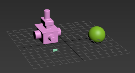

The grid will give you a reference. The center is in the cross of the two black lines. You can see the grid with the letter G
If you use the move tool you will see in the bottom the coordinates of the pivot of the object. If you right click in the spinner of each number it will reset it to 0 and will move the object to the center.
This works also with subobjects as faces, points etc
If you have several objects selected instead one this won't work. You need to group them first and will move them in reference to his common pivot.
Notice that pivots are not necessarily always in the center of the object but they will be used as reference to move the object. You can edit the pivot  in the pivot section of the command panel and center the pivot to the object if needed. Remember to leave the edit pivot after that or you will be moving the pivot instead the object.
You can also align the pivot to a sub object or selection of sub objects. Then any transformation of the object will use that pivot.
