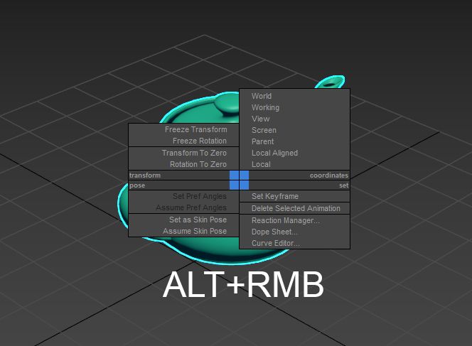

Edit: And if you specifically need that Freeze Transform in the menu, it is Alt + Right Mouse Button.  With 3ds Max, there's like 6 or so right click menus, when also using combinations of Alt, Ctrl, and Shift.

3ds Max has a "Freeze Transform" command from the alternate Quad Menu. ALT+right click. But it is not anything like the Maya command. The 3ds Max command adds another controller and it does not display any transform values as zero. It just stores the values that existed at the moment the user issued the "Freeze Transform" command. User can restore those values, again, by ALT-right clicking, and choosing "Transform to Zero". But it's completely bogus because there is no "zero" involved at all. It's just storing and retrieving some values, it's not displaying zeroed-out transforms like Maya.

For freeze Transforms use Alt+RMB. you get different quad menus if pressing shift; Alt; CTRL+ALT; Shift+Alt.
Just noticed you said it is not working. Check your settings and customize your quad menu. Depending on max version is under customize>customize user interface for older versions, customize>Menu editor for the latest version of max.
