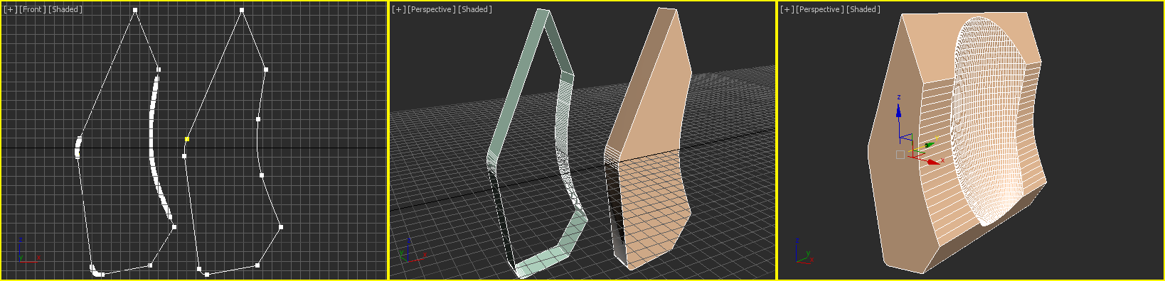

I'm at a loss trying to get the imported objects to boolean correctly at all, yet if I re-create the Line013 object within Max it will boolean perfectly with the imported Sphere003. I have a suspicion it is to do with the relative mesh densities of the 2 objects - the number of vertices used to create the curves, because when I recreated Line013 I did so with many fewer vertices and used the Bezier Tangents to recreate the curves. This is somewhat confirmed by using the Section Shape to create a Slice though Line003 - adding an Extrude to that shape fails to cap the ends. My modified shape however extrudes correctly and booleans correctly.
Working Boolean
Left image is the original section (left) and mine (right). Middle image shows the result of adding an Extrude. Right image is the result of a ProBoolean (subtract) with Sphere003.

I see, so the problem was that the spline was created poorly from the beginning. Ok, will re-study the basics and then move on.
Maybe creating a simpler line, boolean, then apply some chamfering to smoothen out?
THanks a lot for your time, Steve!

Not poorly, just too complex for the Booleans to handle (it seems).
Simpler line yes, but if you do it carefully you should be able to match the original curvature very accurately so removing the need for Chamfers later (which have their own problems as you'll no doubt discover 😉 ).

Effectively yes, as that's how the Section shape created the Spline I worked with.
I removed all the vertices defining the curve except for the 2 endpoints (obviously) and one at the center of the curve (converted that one to a Corner). I then used Fillet on that middle one to give a close approximation, then just moved the 2 vertices created by the fillet, and their Tangent Handles, to get the final result. I did it by extracting the Shape twice so I had the original to work to as a guide. The differences were very minimal - I had to zoom in a long way to see any divergence in the splines - and I didn't spend too much time doing it as I was testing a theory, not my modeling skills 🙂
