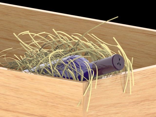

Hi!
What's the best/easiest way to achieve something like the picture below? Any ideas?
1482322_stock-photo-wooden-case-with-two-wine-bottles

keith_brown
Sorry for being unclear. Thanks for your time describing though!
It's actually the wood wool (straw) I needed help with.
leeminardi
There may be a way to model the straw with hair but I have never used the hair features so I created a single spline and assigned it a rectangular renderable thickness and adjusted the length  and width to something I thought looked good.  I then clone copied it a few times and made some vertex edits.  I copied the results and rearranged those then another bulk copy and some random moves.  Here's the results.  More copies should be made to increase the density. The approach may have potential.
lee.minardi
In case it took you a while to arrange and place all the splines, I would suggest you explore the scatter tools(you can even pick the opject you are scattering on and use it as your surface for the tool), or using different maxscripts/plugins from online that can help you adjust the parameters of scatters objects and such, a lot of good ones are free. check out scriptspot.
