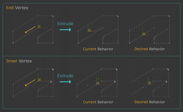

  • Spline (Smart) Extrude Improvements
    • If the end vertex has an out tangent, the vector of that out tangent can be used to extend the end of splines. When you are in local mode the gizmo could orientate to the handle. A slower alternative is part of an older request of making the handles snappable so that the working pivot could be aligned with their direction.
  • shift dragging a vertex inside a segment could act like the Refine tool adding a new vertex and subdividing the segment (like ctrl+ drag does in Cinema 4D) and not creating an additional one end connected segment (if an end vertex gets extruded) or two additional vertices and a disconnected segment (it it's one of the inside vertices).
  • this behavior could have two ways in which the new vertex travels along the spline: a strict one which is similar to Edit Poly Edge constraint (it will strictly follow the segment direction) and a looser one which allows free movements in all directions (I think this is the default behavior with ctrl+drag in Cinema 4D)
  • Ability to move the selected vertex (or the cloned vertex) in the direction of the outvec/invec depending on where you move it (holding CTRL or any other modifier key) without the need to alway reset and aligned the Working Pivot
