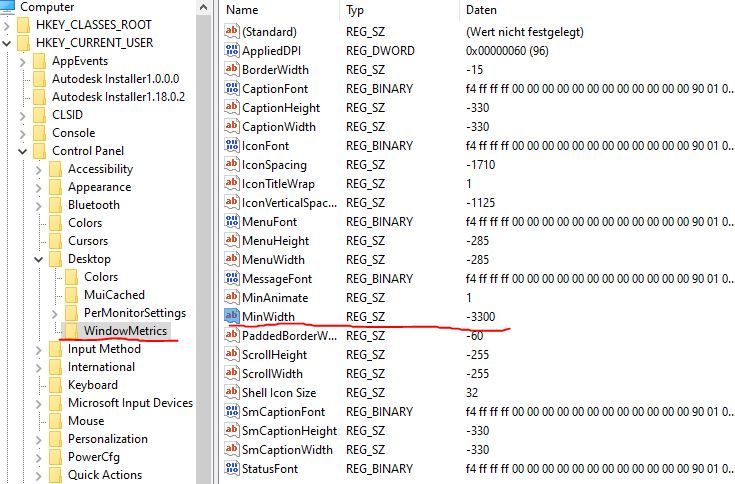

Hey guys, maybe you already know this, but I just found this post yesterday. It is working for 3ds max as well:
https://forums.autodesk.com/t5/maya-forum/no-text-on-minimized-windows-inside-maya-2017-on-windows-1...
Seems to be a general Autodesk / Windows 10 issue no one cares about.
You need to fiddle with registry. Hilarious, isn't it?
It's a workaround ending in this:
But hell! Removing a tick from your but must feel the same 😉
No more window lottery!
Just in case the other link will not work:
Enter regedit in Windows search bar and open Registry.
I made a backup of my registry before this via export. You never know 😉 This can take a while.
Go to this folder:
You need to add MinWidth - it's not there.
Right click / New / String Value
Name it MinWidth and put value on -3300.
I have no idea why -3300. I tried -2000 - didn't work.
Now, you need to restart your computer.
Done!
No guarantee of course.
But it is working here and it feels great.
