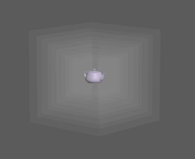

Here is an example of a teapot with five hollow cubes surrounding it. All cubes have been set to Xray mode, yet it is kind of hard to make out the exact shape of the teapot.
Here is the same scene, except that the Visibility track has been set to 0.1 for each surrounding cube. With this visual setup it is much easier to see the actual teapot, but still get a sense of the surrounding cubes.
Conclusion: It would be very beneficial to be able to set the transparency level of the Xray/See-Through mode independently from the Visibility track so that the Visibility track can remain untouched if more transparency is needed.
