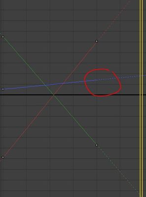

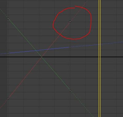

fcurve selected key frame bug - a graphic bug occurs when a keyframe is selected on an fcurve in the graph editor. the keyframe graphic disappears, though is still selected and active. Unsure what is the cause as it doesn't happen every time.
see below for reference images
 XYZ fcurves with keyframes deselected
X keyframe selected showing bug 
Z keyframe selected showing bug
Y keyframe selected working correctly
X with two keyframes ( entire fcurve) selected working correctly
XYZ keyframes selected working correctly
