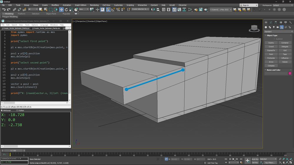

It would be a really good idea to have a extrude direction option in modeling, I'm not talking about "Extrudie along Spline", I mean a temporary vector, like "Tape" to set the direction of Extrude (or Move and Bevel, etc).

Something like this:

Ok, I don't want to wait, here is a simple python script for set the direction of working pivot based on chosen direction (it works in 3Ds Max 2021)
Download From GitHub: https://github.com/ShirzadBh/tutorials/tree/master/2_extend_direction
