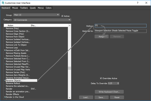

Currently, most people use F2 to shade or unshade polys while modeling. 3ds Max has a robust customization system. It is pretty simple to change this without us changing the default and affecting the majority of users.
Go to Customize -> Customize User Interface, find and select Rename Objects, then hit F2 on the keyboard, and press the Assign button. (See the attached picture.)
