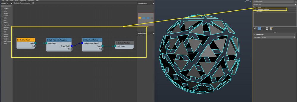

JadBox
I know your talking about elements to objects but it's possible in MCG to split the mesh to polygons in a non-destructive method I'm not expert in mcg but maybe this will help you for now, check the attached image for the mcg graph.MCG GraphMCG Graph
