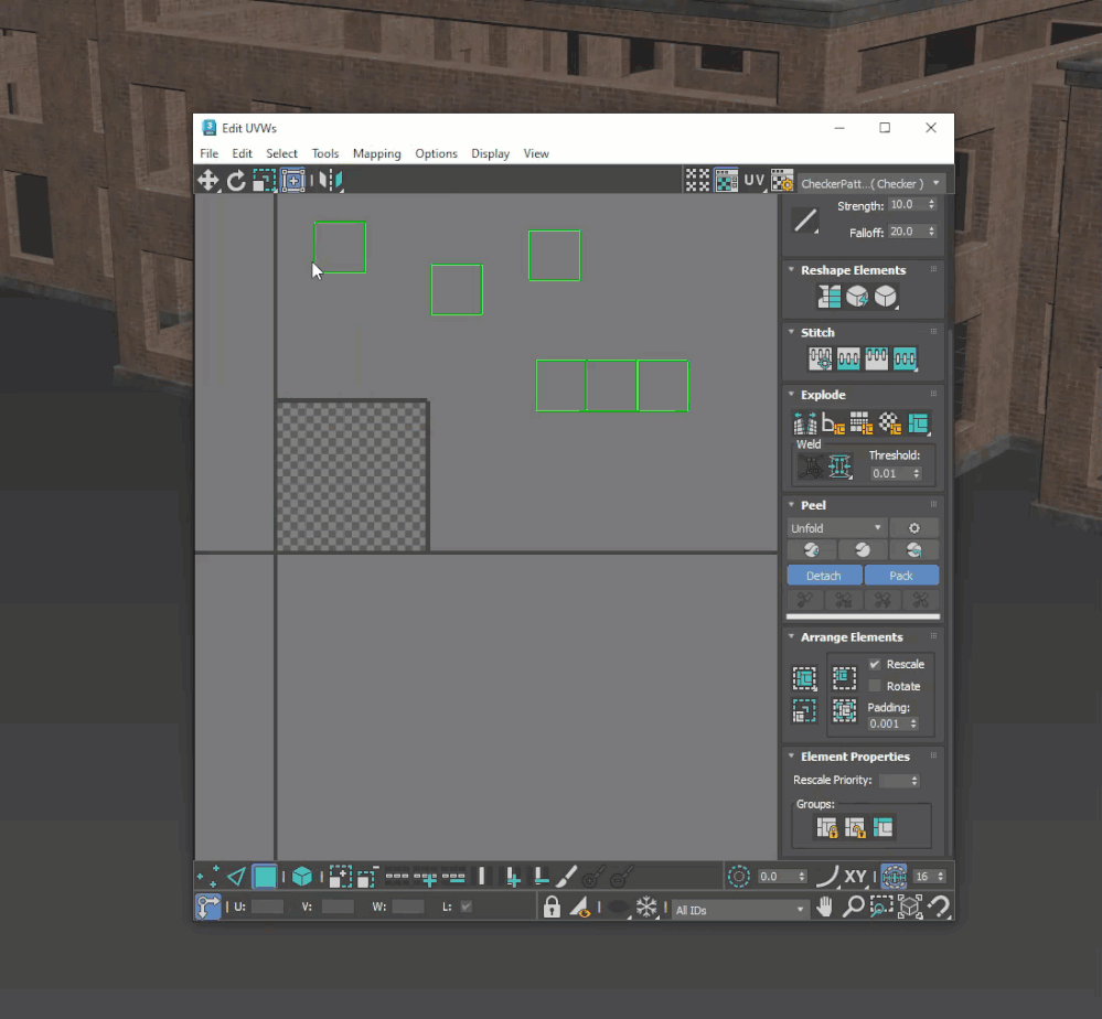

Is there a way to only pack the UVs you have selected? Every time I select specific UVs and click pack, it packs every single UV.

 I guess you must be using Pack Normalize  which does pack all UV islands regardless of which UV islands are selected.   However  Pack: CUSTOM or Pack Together only will pack the selected UV islands.  Switch to one of these options if you only want the selected UV islands to be packed.
Message 3 of 15
Milosava
thanks for the reply but both pack custom and pack together both do the same thing. I swear yesterday it was working fine. I was not using park normalize.

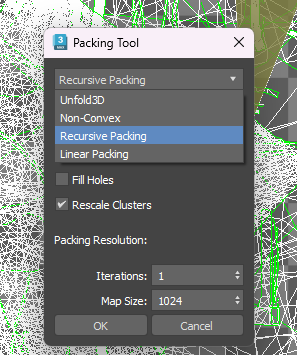

I opened the Packing Custom Tool Options and changed the mode or whatever from Unfold 3D to Recursive packing.
Not sure what this means or what else it changes but I am now able to pack selected UVs rather than everything no matter the selection.

"I opened the Packing Custom Tool Options and changed the mode or whatever from Unfold 3D to Recursive packing."
I am glad its working for you now, but for Max 2022 and Max 2020,  changing this option to Recursive Packing did not affect Pack:Custom  packing only the selected UV islands for me.   Maybe this behavior has changed in Max 2023 and I don't know whether it is intentional or a bug but the docs only say that Recursive Packing "Packs the clusters efficiently, but is slower than the Linear method."   Maybe someone from Autodesk can provide insight on this.
Message 8 of 15
Milosava
@10DSpace
I installed 3ds Max 2022 and it has non-convex packing set as its default packing method. In 2023, its default packing method is called Unfold 3D which seems to be an entirely new feature for 2023.
I will just set it back to non-convex or leave it to recursive packing.
