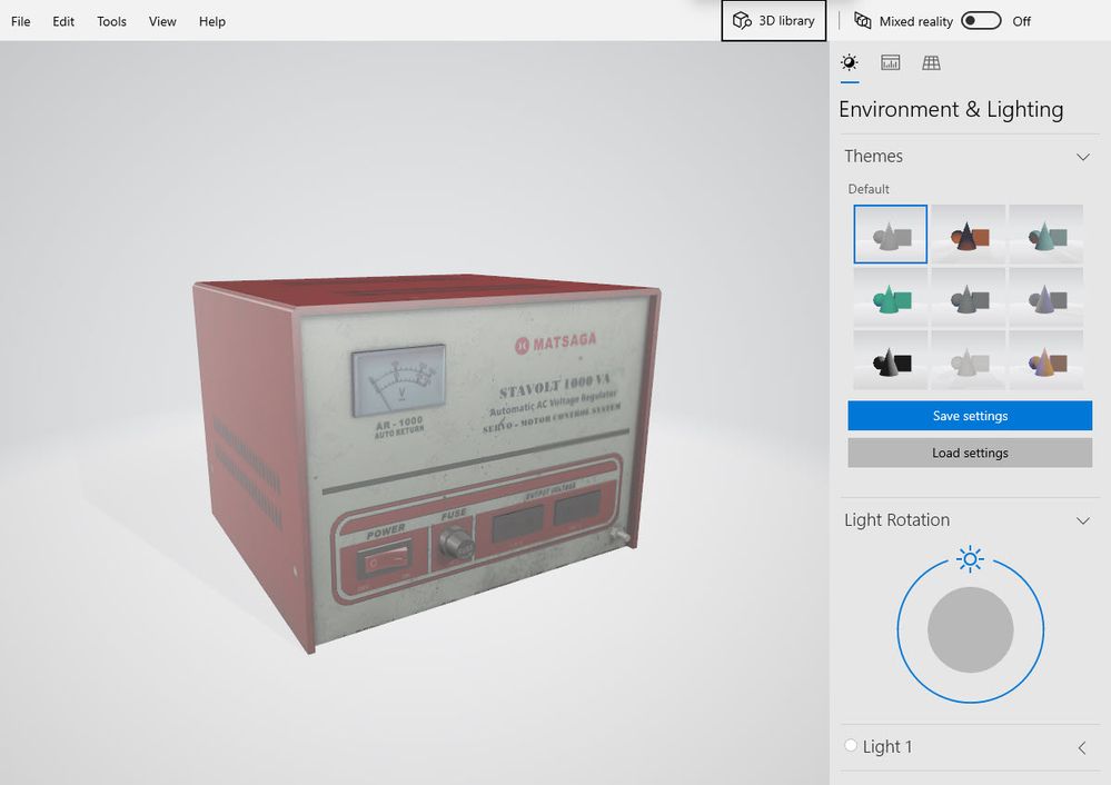

A case that shows the lack of consistent behavior by the 3ds Max export to OBJ function has been found.
These OBJ+MTL files were generated by my laptop:
These OBJ+MTL files were generated by my desktop:
As far as I can tell, both computers are equivalent. They are running the same OS (Windows 10) and the latest version of 3ds Max 2020. The MTL files are essentially identical.
The model in question may be downloaded from here:
Vintage Voltage Regulator
-Ramon
 It seems like the best way to know whether the Full Export worked is by noticing the dialog below:
These 2 succeeded:
This one failed:
-RFH
