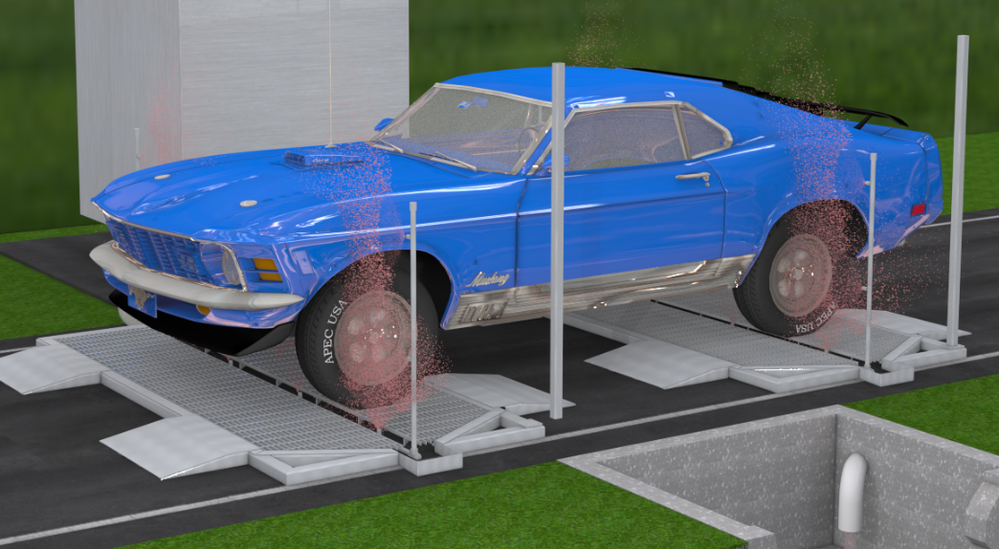

Can someone tell my why this particle spray will not render? at frame 558 only the left spray renders. It shows in the scene
strange the right super spray stops generating around frame 500

Oh well ... good old superspray.  It's code must be nearly 25 yrs. old already. You should'nt use it for such high particle counts in my opinion. I think you are simply hitting some internal particle count limit here ( my suspicion is that it lies at somewhere near 65k particles per system with the old legacy particle systems )
Proof:
As you have set the "percent of particles" display amount to 10% only, only 10% of your total particles are created and displayed in the viewport. This apparently works without hitting the limit.
At rendertime, 3ds Max tries to create all 100% of particles, but fails so because of some internal limit ( my guess )
You can easily repro this in the viewport too, by dialing the "percent of particles" spinner up to 100%: now even the viewport fails to display the particles
This only happens with the right particle system, because it starts earlier to emit ( at frame 400 ). The left one starts later at frame 507, thus does'nt hit the limit .. )
So either tune your particle spawn rate or your particle spawn time frame

What would you recommend to use for a decent spray affect? PF Source? The last time i tried using that i had to have two deflectors because it made a conical spray and not a flat spray.

In this instance im looking for a spray to look like a pressure washer spray. Fanned and flatspray1.pngspray2.png
