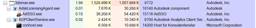

  • First it would be interesting what 3dsmax version you are using.
  • So the process starts with 3dsmax and closes with it?
  • Then, can you perhaps check with Task Manager or  Sysinternals ProcessExplorer the QtWebEngineProcess if the Memory leak occours?
  • Did you try to kill the process using Task Manager? Does RAM usage go back to normal?
Here you can see on my system the process attached to 3dsmax:
this is after closing the Welcome Screen:
Perhaps you can check if the process is also attached to other applications. You can of course skip this part, if the process closes with 3dsmax You can also try to Kill the process. And we can probably include @brentscannell again in the conversation with more info from your side. Maybe @Anonymous  found a solution.
