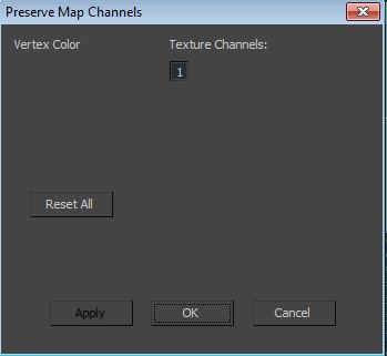

I use first changes and after preserve uv and vise versa but nothing happened, also there is very strange setting in Preserve UV settings there is nothing on left hand side in the list.
 I have the same dialogue box, I don't think there is anything wrong with it.  It is for vertex color channels on the lsft side which if you haven't set any up nothing will show.
