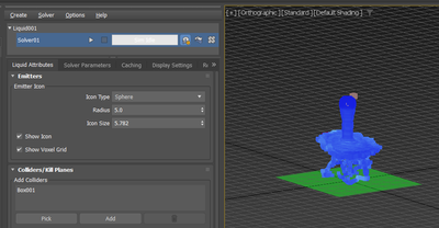

I'm trying to run a liquid simulation in 3ds Max 2026, but it simply won’t start.
I've tried several solutions — including reinstalling 3ds Max and even formatting my computer — but nothing has changed.
To rule out scene complexity, I created a very simple test setup (as shown in the attached image). However, even with just a box and a plane, the simulation remains stuck on Sim Idle — the play button is disabled, as you can see in the screenshot.

Can you please talk us through those three screenshots?
I see the Liquid001 > Solver01 > Play button - but to me it does not look disabled.
Have you tried clicking it? It should start the simulation.
If that does not work, here are two more suggestions:
1. Start from scratch and follow the official tutorial step-by-step - does that work?
2. Could you please share a .max file with your simple test setup so we can inspect what is going on?

Not sure what is going on but the latest Liquid Test.max file works for me out of the box.
Just loaded the scene into 3ds Max 2026.3, selected the Liquid001 object, opened Simulation view and hit the "Start solve" button:

Well, in fact, my 3ds Max is the Student Version — I don't know why the system didn't acknowledge this, but it is.
I asked Copilot about the issue, and it pointed to a supposed “limitation” of the Student Version. But after reading your question about whether such a limitation even exists, I decided to search again and asked Gemini (which is set to give me precise answers). It confirmed that there are no limitations in the Student Version. Even better: Gemini helped me solve the issue.
I never imagined it could be something so simple. My 3ds Max was installed on a secondary partition (not on the main C:/). But the system used by 3ds Max to simulate liquids and other effects (called Bifrost) processes a large number of changes and physics calculations, and because of that, it needs to be installed on the same partition as the Local and Roaming folders (the main partition).
Well, this is a summary of Gemini's solution. The most important part: the liquid simulation is running now.
Thank you for all the support you and the community give to these questions.
Message 16 of 26
MartinBeh
Interesting. So you say the simulation does not run when 3ds Max 2026 is not installed on C:\?
