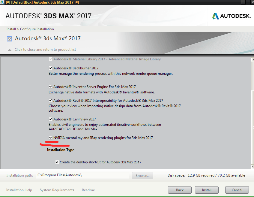

I have found this screenshot in Internet about how to install the mental ray plugin in Max
However... with Max already installed, I don't know how to get this screen and force the installaton of the plugin without having to uninstall and reinstall everything.
Also, even if I have to uninstall and reinstall, I don't know how to reach this screen, Configure Installation.
Where is it?
Cheers

Just click the small arrow below the "Autodesk 3ds Max 2017" checkbox and those options will appear

In fact, I don't know how to arrive to that particular screen "Configure Installation", in which you can select the NVIDIA mentalray plugin installation.
When I install 3DS Max 2017 the first screen I get is this one:
I've pressed Install (and with this, you won't get the mentalray plugin installed).
Should I execute again the installation and select Install Tools and Utilities?
Or could I download the mentalray pluin for Max 2017 from Autodesk or other place?

You don't get any dialog after the first one ?
For me - the next dialog after the one with the big install button that you show in your post is this one
Then i click on the small triangle marked by the red arrow and get to following dialog
You really do not see those two dialogs ?

to be honest, during the installating I think I did not click in the arrow... 😞 just next...
So probably I installed it without the mentalray plugin...
