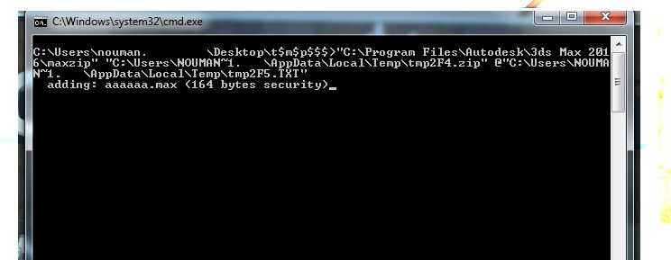

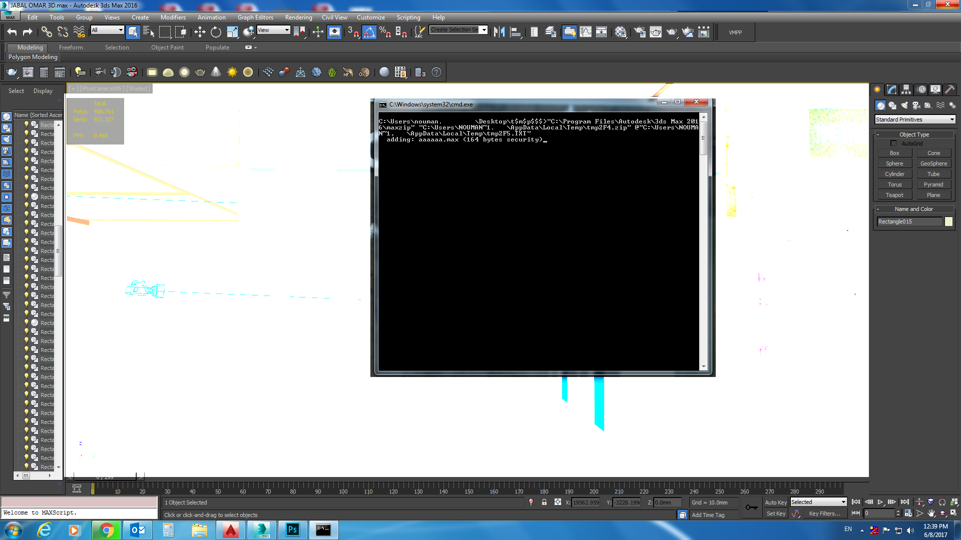

Message 10 of 11
I have solved this issue as mentioned in my previous comments that some software been blocked by antivirus or by company policies to secure the system from attacking virus.
when you click on save as >>>> archive >>> then select any location where you want to save >> press save
after this it gives you an error
File save error
File archive failed ( code 1 )
that's because of cmd.exe , which is sometimes blocked and creation process of archive file based on  cmd.exe software as I showed in below images, so if its blocked it will give you the same error as mentioned above Untitled-1.jpg2222.jpg
I think this will help you.
