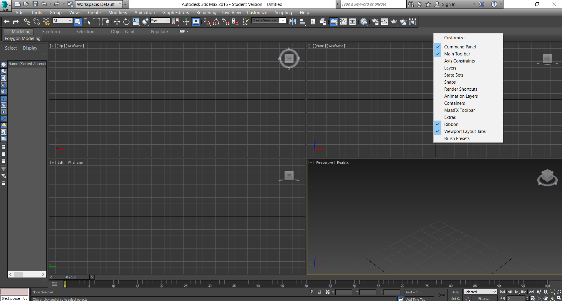

Hey All,
This may be an easy fix but I can't seem to get it back. I have tried resetting 3ds Max, reload the default UI since I customized it to my liking, I even tried turning off then turning back on the command panel, and nothing works.
Any help will be appreciated.

Alfred.DeFlaminis
Hello @Anonymous,
Sometimes if there is a bit of lag the command panel or other panels can get closed as a user clicks around waiting for Max to respond.  I am very guilty of this.  Most likely what has happened here is that it was disabled (if it's not out of screen as suggested by @blakestone).  In that case, to re-enable it simply click as shown below.  I hope this helps and if not we'll keep digging.

Yeah, still no luck on that one either... I had disabled, and enabled it as well. Could it have something to do with customizing my UI? I had set it up to my liking, but only created some shortcut keys to use certain tools quicker.

I renamed my ENU file to ENU_Old had fixed it.

I was having a similar problem where my command panel was missing. I think it may have been caused by leaving it on during a sleep cycle. I tried all all the threads pertaining to control panel toggle, UI interface reset, load another custom UI, and checking my display setting because I do use a two monitor setup at home.
Deleting the 3dsmax.ini file was what worked for me. I remember that I had another issue with crashing after installing an extension and doing the same thing helped that too. Since 3ds Max creates a new 3dsmax.ini if one cannot be found, it restores default settings. Just remember to change your preferences back to what you need!
Thank you all!

imagestud
Have experienced the same problem.
Right Click in blank area of Main Toolbar.
Choose "Customize", then select "Menus" tab.
Choose "Reset" button @ bottom right.
Worked for me.
