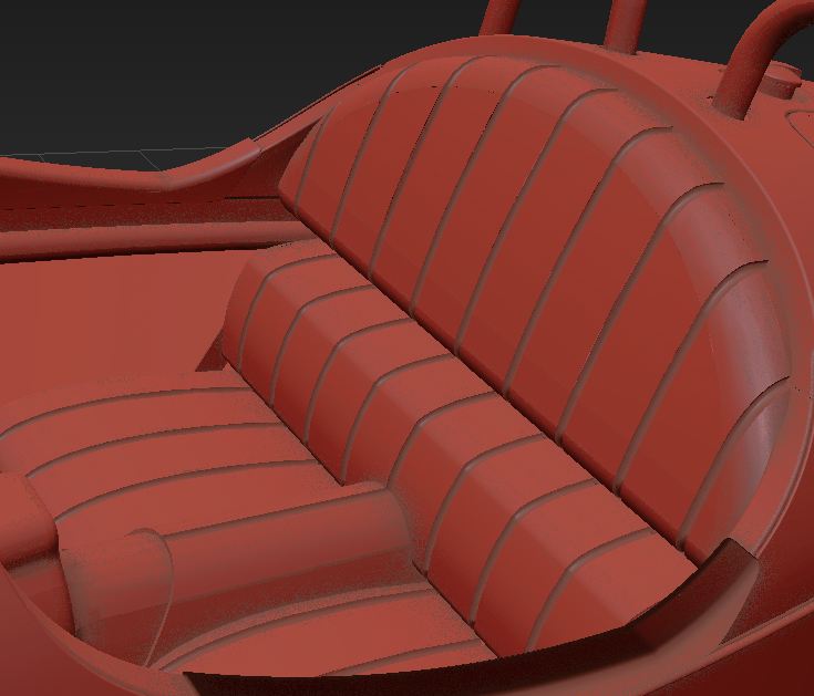

hello ; important parts are missing in the model !
and can i remodeled the seat and add small parts on the body for better result ?
Message 11 of 38
MarionLandry
Hi seghierk
Yes, you can do whatever you want or need to the model in 3ds Max Design.
We are looking forward to your advertisement design.

Message 12 of 38
MarionLandry
Hi seghierk
Yes of course. If you want to add some details and better the model, please go ahead.
You can have a look at the http://www.morgan-motor.co.uk/ web site for inspiration.
You can see how detailed are the seats of the 3 wheeler and perhaps the missing component.
Have fun!
Marion
