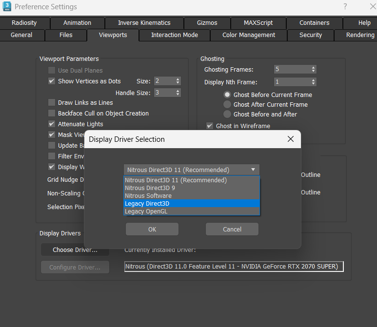

Hello, I was using the old Max version and recently updated it to Max 2024.
The Blend Map of Render To Texture, which was previously used in the 3Dsmax 2014 version, does not come out properly.
The settings have not changed except for changing from Legacy Direct3D to Nitrus Direct3D 11 in Display Driver Selection. Why does the map show shadows even though I unchecked them?
Legacy Direct3D can no longer be selected on the newly installed 3Ds Max 2024, as an error is occurring.
I want to set up a Bland map so that the entire map comes out as well as the area shown on the screen, so please tell me how.

First thing I would try is to make the material self illuminated.  It's cutting out the parts that aren't visible to the camera.  (At least, that's how it appears.)  Chances are the backfaces aren't getting any light, and self illumination is the best way to get an even bake there.  At least, it used to be.

I understand, but the viewport has lighting.  Because you are capturing the complete map, you are also getting the lighting.  Apply the texture to self illumination and just bake the self illumination channel, or make the object self illuminated with the map in the diffuse slot, either way gets around the issue.

I was looking for a self illumination material, but when I found the standard material I used before and applied it, it came out well without any shadows. Thank you.
