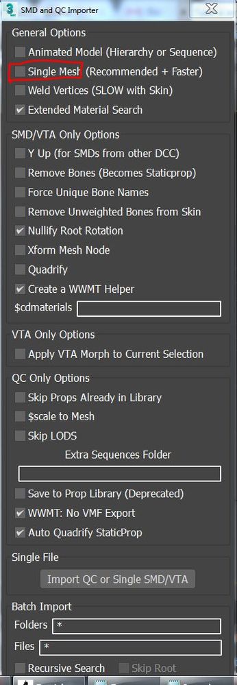

RadioRahim
thanks again for your reply and attention on this matter.
What i mean by layers is that in Milkshape when I open an SMD file, there are different groups (or layers) of the mesh that are separated by which texture they are applied to. So imagine that each layer is assigned to a different texture and those meshes are separated likw so:
In Milkshape we are able to work with each individual layer and by being able to do this we are able to adjust the texture mapping (UVW) for each texture separately.
When I import the SMD file in 3ds Max I am using settings:
As you can see the 'single Mesh' option is disabled but after import I am only left with one single mesh. What is odd (as I said in my last post) is that if i export this to SMD using WW export and import into Milkshape the layers are separated again.
None of this may matter as the end goal here is to be able to fix the texture mappings because presently the textures do not come out correctly in game after exporting from WW. I do not know if there are any setting for import or export that preserve the texture mapping that I should know about?
The way this works is that I export the SMD as the model and export the texture data in an MTL file created by exporting on OBJ file. Those two files (the MTL & the SMD) are what are used to make .BIN files which the game reads. Doing this with Milkshape works fine but in 3dsMax it seems that the layers are merged and that the texture data gets lost on export ). The textures look fine in 3dsMax, and are applied properly to the model, but they are not reflected properly in game using the WW export option.

After looking at the model in Milkshape, I discovered the source of your issue. WW normally strips out non alphanumeric characters (like spaces, periods, etc) and removes the file extension to be Source friendly. The file extension was only included if the Engine is set to Goldsource in WW and then it was always using .BMP since that is the file type used by Goldsource. I have updated Wall Worm to have a new global setting to always write the extension. If you update WW, you can now export how you intend.
  1. Update to WW 3.25
  2. In Global Settings  (Wall Worm > Settings) turn on Extension in SMD in Models Tab
  3. Turn on Legacy Mat Names in the Materials tab of global settings
Below is your scene in Max as well as Milkshape.
Note that I would still use the Single Mesh option on the SMD Importer. It works faster. Also you will work more efficiently if using Max 2018 because some functions were sped up in that version of Max. Moreover, your exports will be faster as well if using WW Pro.

I believe that you may have a fundamental misunderstanding on how 3ds Max itself or Wall Worm works.
Yes, the materials are kept separate in the imported SMD. The representation of those materials in Max are not necessarily identical to how it is in Milkshape. You will need to learn Max techniques/terminology and not think of things in terms of Milkshape.
As for the "Layers" you mention, this is not the terminology that is correct in a 3ds Max context. In Max, there are two separate "separations" of the data. On one hand, there are Nodes (which in the SMD are defined as bones)--some of whom have vertices and some that don't. On the other hand, each node has an array of Material IDs that determine what material appears on each face of the node.
If the imported SMD has one bone with meshes, you'll get just one imported mesh.
If the SMD has multiple bones with associated meshes and you keep this options off (Single Mesh), then you'll get as many mesh objects as there are meshed bones in the SMD.
On each meshed object, you can get to each "layer", as you put it, by selecting the mesh, going to the Modify tab, change to either Polygon or Element sub-object mode and scroll to the Polygon:Material IDs rollout. From there you can select each "layer" as you'd call it. (There are other ways you can get to each set of material parts via modifiers... but I don't have time to explain them all).
