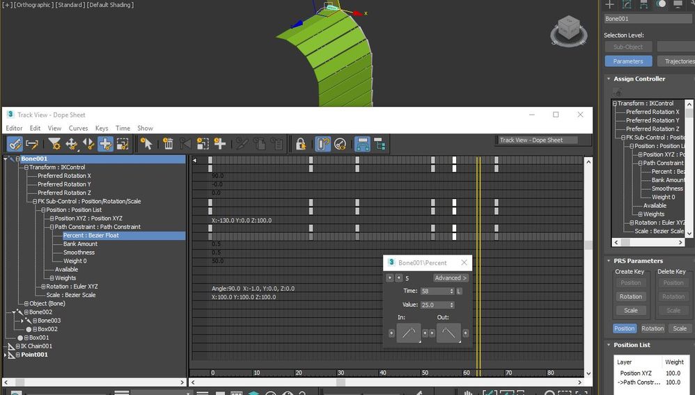

Here's another approach that may do what you want.
1. Create a string of bones with the lenght of each bone equal to the width of a single slat of the shade.
2. Create a box to represent one slat of the shade and link it to the first bone.
3. Edit/Clone/Instant the box and move to the next bone. From this point you can Edit/Clone 2 or more boxes to create the rest of the boxes. I used a grid to snap to to easily create the bones and boxes to the correct size and position. Link each box to its respective bone.
4. Select the first bone and Animation / IK Solvers / Spline IK Solver and select the last bone and then the spline.
5. Open the Dope Sheet and for Bone001 change the assigned controller for Percent from Linear Float to Bezier Float.
6. In the Dope Sheet add keys as desired right click on the first key and change the percent values as desired then change the values for the other keys. I suggest using a linear transition between keys as a start.
