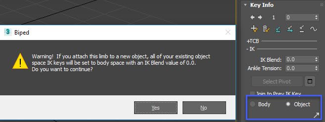

The Biped "Object" option :
Triggers this message box on assigning an Object to it. That is expected, this will get the Sliding / Planted keys to regular body FK keys.
The object should be assigned before doing those keys or edit the keys again after assigning the object.
A single object can be set per Limb, the object can be changed, but can only be a single object per animation. Each time the object is changed, the Keys will be reverted to regular FK keys.
This is because the IK reference system (the object) can only be one reference system.
When attaching Biped via this method, Biped limb (hand or feet) will follow the object, the object does not follow the Biped.
If you want the Object to follow the Biped, the set up will be different.
The Max object will have to use either a Link Constraint or a Position and or a Orientation constraint.
I do hope this can help why sliding / Planted keys can get undone.
