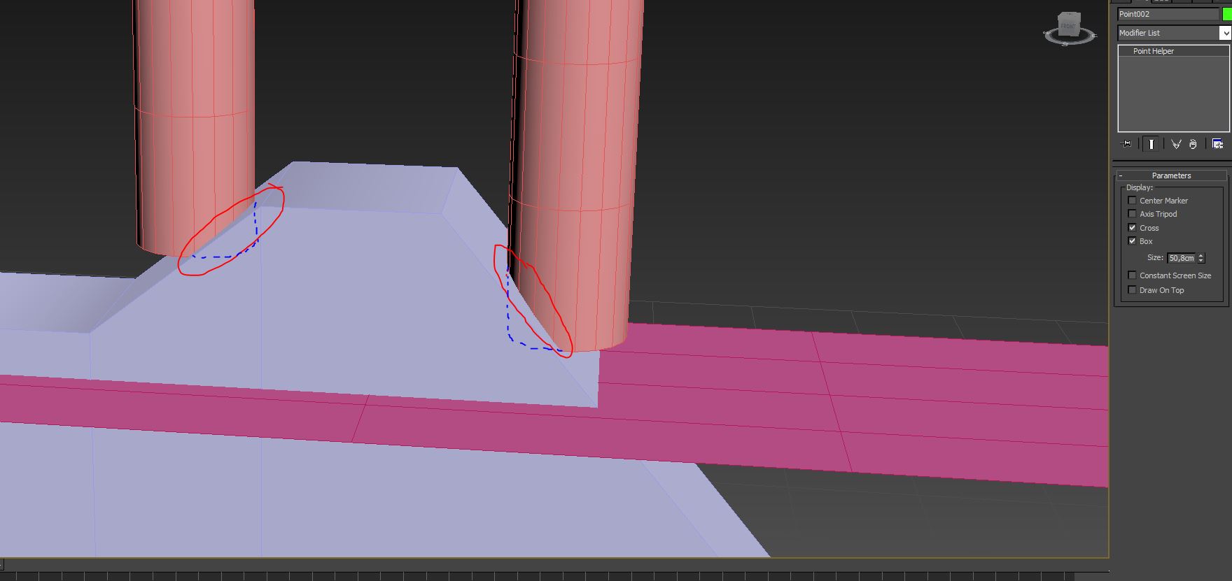

HI
Pls, can you help me?
How to create a movement of the cylinder and strings up and down? (According to the shape key)
https://www.youtube.com/watch?v=Wtl2hmHZCLw
Thank you!
Message 26 of 28
ads_royje
Hi again! 🙂
Sure thing! With your video reference, it makes it so simple to answer!
Hopefully, you are using Max 2016 or 2017, as the feature I am proposing exists since Max 2016.
In Max main menu bar > Animation > MCG Controllers > MCG Ray to Surface Position.
That is the tool you are looking for.
This controller needs a minimum of two external objects ; a surface to collide to and a ray caster to determine the director to go to.
In the attached video, I do a step by step set up.
The MCG Ray to surface controllers uses the Ray caster Pivot to cast a ray until it collides to a surface and stops on it.
There is a float field to set an 'offset' from the surface for a maximum of control.
It needs a minimum of 1 surface to collide to, but can have many of them.
In the attached video, I use 2 colliders, a key and a plane.
The plane is the 'rest' position collider, where the internal cylinders are resting before the key goes in.
I hope this can be as clear to use as possible! 🙂
*edit:* oops crap I just realized that the audio did not record in the video. If you don't get to understand with the visuals, let me know. I'll create a new one ... terribly sorry for that 😞
Message 27 of 28
Thank you!!
Very help me! You are awesome 🙂
However, when the animations have to be a perfectionist. Now it starts to rise up from the axis. Not since the first contact. pls help. I appreciate it. Thank you very much.
