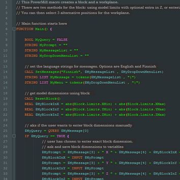

I have modified the theme a bit as I prefer when I work with my macros to have a darker background. I am not sure about the text colour combinations but here you are:
When you load the file as Pekka described please remember to change the style to Obsidian.
The drawback on the Obsidian theme with the dark background is that it does not work well with the compare feature.
If you want to compare files you have to change your theme.
Kind regards
George
