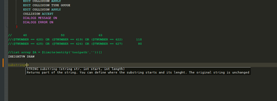

moraschini
Hello Everyone, i hope to be usefull for someone of you,
today after many test i find a solution to add the hint and the autocompletion in notepad++ 8.6.
you have to copy the file in attach in "C:\Program Files (x86)\Notepad++\autoCompletion\"
with this passage i get this result.
have a good day

Message 28 of 30
arnoldiW3K8A
hello, you need the powermill language that you load from
language>User Defined Language>Define Your Language...> import...
here you have to choice the powermill language, in attached the one created by me
close notepad++ and reopen, open a file with extension '.mac' and start writing.
if everithing works fine when u start writing it should show the hint and on the function (maybe with ctrl+space key) the terms of the function.
Message 29 of 30
nguyenthinhvt95
Now It's working well.
