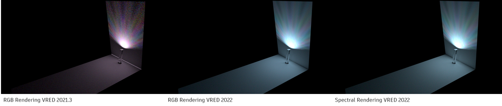

Light Spectrum Improvements
When converting a spectrum to VREDs RGB based color space it can result in colors that are outside of the color gamut, creating negative values. In VRED versions before 2022 this led to wrong colors, especially when using RAY files with a single wavelength per ray.
Note: Material colors must still be clamped to the 0-1 range in RGB to avoid wrong calculations.
Also, this change will significantly change the render result for those cases where out of gamut colors occur. All cases without negative values in their RGB should be unaffected.
