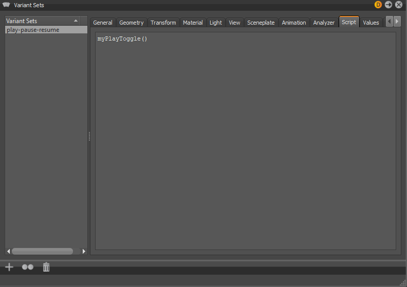

Christian_Garimberti
write the myPlayToggle() in the script section of a variantset
then connect the variantset with a touchsensor
this should works

Message 15 of 25
marcus_fritzen
the script was only a hint how things could work and yes, there was a ":" missing behind "else".
Besides that, c.garimberti already wrote what you need to do. Create a VariantSet, put the myPlayToggle call into the script tab, create a touch sensor and attach the newly created VariantSet to it.
