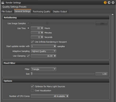

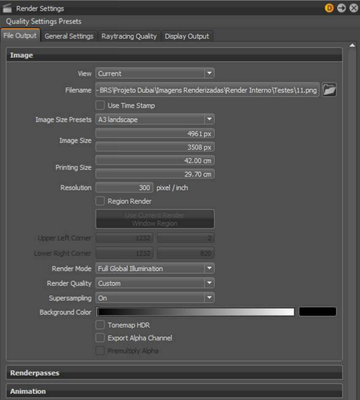

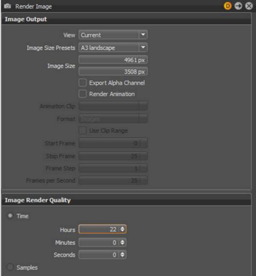

Hi guys, thanks a lot for all help, I just discovery all settings are basic:
11223344
I will try to use some other options and try to tune some others like you guys told me.
Son I can get, o will post some results here.
