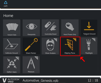

Hi everyone,
We would like to manipulate the clipping plane during a VR session. Right now someone from outside can change the position and the angle of the clipping plane but it would be much more intuitive if the person with the headset can move the clipping plane. While I was researching regarding this I just saw a help page where it seems like there was a Python code for this (here). However when I follow the link, it sends me to a page where the only thing I can find is a list of Python codes I can use (Module vrClippingModule). I can see that we can build a new tool by using these functions, but it seems like there is already a tool for this. I am attaching below the screenshot of what I can see on the first help page.
Can anybody help me with this? Is there a tool for this already somewhere?
Many thanks,
Emre

Christian_Garimberti
Hi, what you see in the video was the first VR Tool provided for Vred. It was not inside Vred buy some python to be added manually.
From the 2018 or 2019 version it was replaced by the actual out of the box VR menu.
You can still find it here: https://www.autodesk.com/support/technical/article/caas/tsarticles/ts/2tj0Q3UeUkNDTWj5zvg5ty.html
Note that it was written for Vred 2017, so it will be quite old...
I think the bast way is to write your own code to add a new feature to the vr menu following the examples you can find in the help
https://help.autodesk.com/view/VREDPRODUCTS/2025/ENU/?guid=11Tutorial-VREDPro
or
in Vr Menu section
Best
Chris
